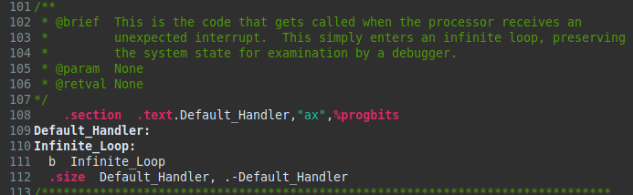

@Community member , there is no "normal" debug possible, first and only thing is start und stuck at : b Infinite_Loop . restart, reset always comes to this line in startup.s no stepping or anything else than leaving debug session is possible. ok, reading registers, flash etc is ok, but no step in program execution.

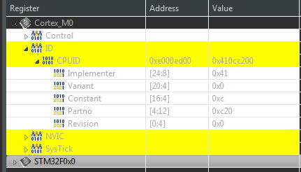

Read the DEVID, might be a different stepping of the IC, or one where ST has changed the die.
Pictures of working and non working parts might also be instructive.

2022-10-18 2:21 AM
so - here we are:
old (1..2 years) board: C8T6 variant
with new chip: C6T6 (because C8 not available)
and ID : (in cubeIde )

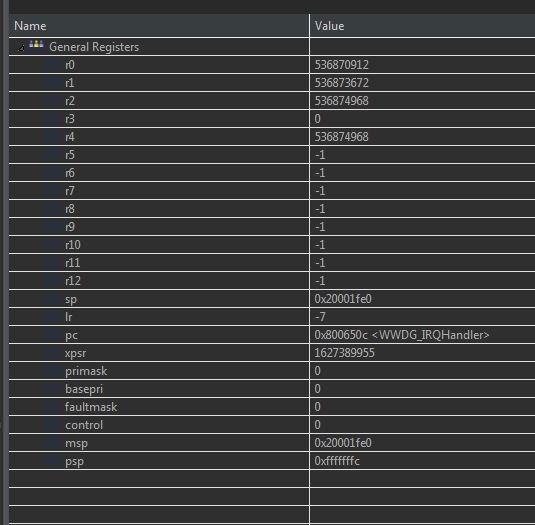

and SCB_ICSR :
VECTACTIVE:
(what is vect 3 ? WWDG ? )
and registers at infinite loop:
so seems WWDG is doing this - but is off.
i had this idea, because WWDG_IRQ shown, but setting option bytes to Hardware and back changes nothing.
any idea ... or kick them to trash ?
2022-10-18 4:02 AM
C6 has only one half RAM and FLASH then C8. If you use bin files for C8, the stack si in nonexisting RAM memory. I would compile whole project for C6 MCU and use this bin.
2022-10-18 4:39 AM
Ooo...i was not aware , that is RAM also different size . ****.
i try...
