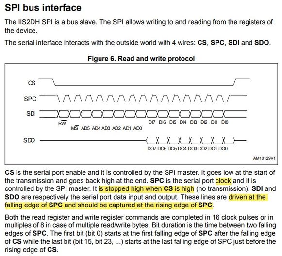

The IIS2DH uses a High clock polarity and data is captured on the rising edge of the SCL.

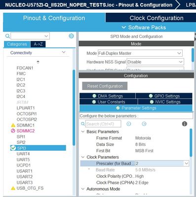

In the SPI3 tab, the mode was set to Full-Duplex Master. The data size is set to 8 bits and the first bit is the MSB. I believe the baud rate sets the frequency for SPC pin, but changing it didn’t seem to have any effect on the code output (I tried them all). The clock polarity (CPOL) was set to High and the clock phase (CPHA) was set to 2 Edge.

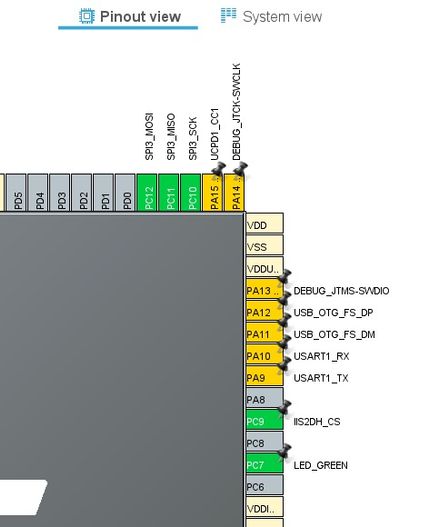

The pins used are as followed: PC9 – IIS2DH_CS (Set as GPIO Output), PC10 – SPI3_SCK, PC11 – SPI3_MISO, PC12 – SPI3_MOSI.

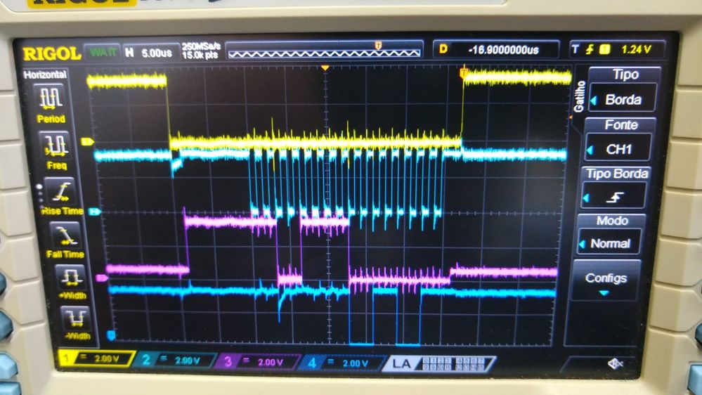

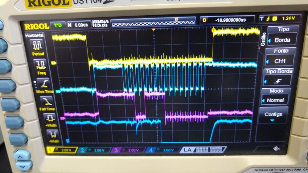

ESP32 ID Reading at 1 MHz
The signal is very disrupted at high frequencies, but it still managed to get a stable reading (at 10 MHz).

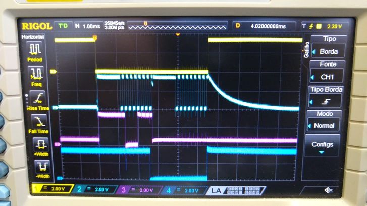

With the Nucleo board, I used lower frequencies to avoid miscommunication between the two components. It is clear that the Nucleo is interpreting the code correctly and sending the correct sequence of signals to the accelerometer. However, in this case, the accelerometer isn’t sending back any data. I do see some errors with the signals, such as spikes in the signals with each rise/fall of the SCL line and the slow decay of the clock after communication is complete (which I would also like to fix), but I can’t see why the accelerometer isn’t answering back in this case.
ID Reading at 5MHz/128 baud rate prescaler with Nucleo U575ZI-Q.
Slow decay of the SCL line
These tests were done on two completely different sets of Nucleo U575ZI-Q and STEVAL-MKI168V1 and the results were the same. Vcc pins are connected to the 3v3 socket and the GND, INT1 and INT2 pins are connected to the GND socket on the Nucleo board, both on the CN8 ZIO connector.

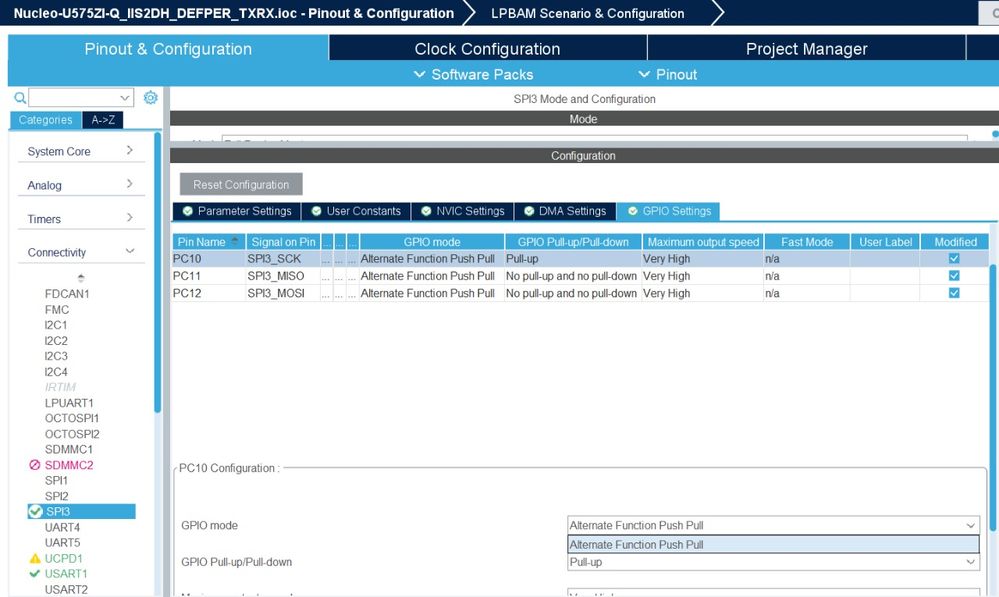

Don't insert code as if it was text. When you insert code, you should click in </> icon in the toolbar.
SPI3_SCK and SPI3_MOSI output type should be push-pull. Where is GPIO configuration?

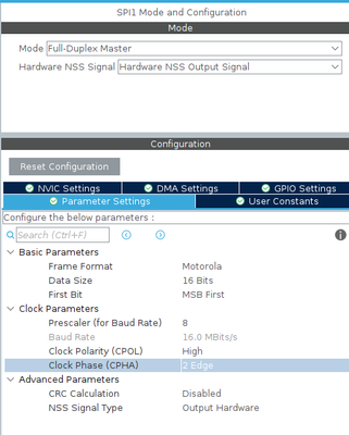

Maybe you have to adjust your setting for the SPI:
set it to 16bit data , (Motorola) MSB first, and clock CPOL high + CPHA 2 edge .
Try... (and write/read uint_16 size , 1 x . (not 2 bytes, as now.) )

About the SCK and MOSI pins, I didn't change their configuration. I haven't had any time this week to tinker around with the components, but I'll post a screenshot of the GPIO configuration when I can.

I apologize for the delayed response. As previously mentioned, the configuration of the SPI pins and the GPIO used for the CS line have not been altered. The only available option for the SPI pins is Alternate Function Push Pull. I noticed that the default maximum output speed was set to low, so I attempted to change this setting. However, the issue of inconsistent readings persists.
I configured the SPI_SCK pin to GPIO Pull-up, suspecting that the rise of the clock signal after the CS line goes low might be interpreted by the accelerometer. This adjustment appeared to help for one of my Nucleo boards, but it did not completely resolve the problem on the other one. I am still investigating the issue. For the other board, the readings remain highly inconsistent, and interestingly, placing my hand close to the wires seems to result in correct readings from the ID register.
DO you know of any specific configurations that might help reduce this interference?

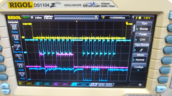

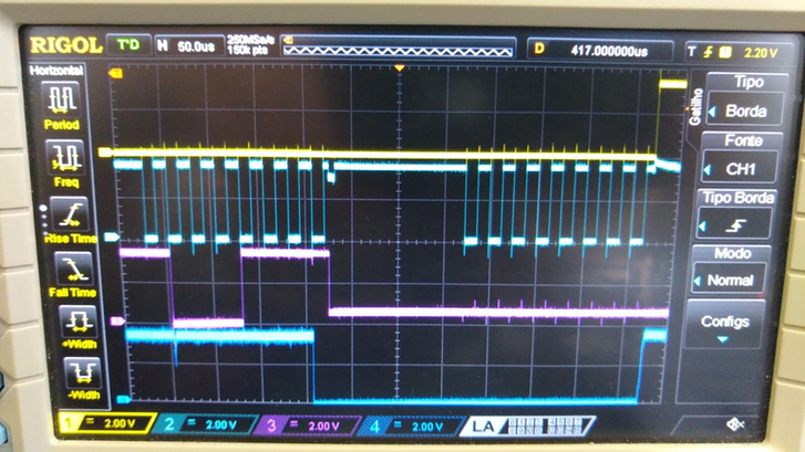

/* USER CODE END WHILE */ Comparing the reading from the ESP32 and the Nucleo, I noticed that the first clock rise was interfering with the communication since it was being put to high after the CS line goes low. I set the SCK line to pull-up in the GPIO configurations and that solved the issue for one of the boards. Here are the oscilloscope readings:
Without pull-up on SCK
With pull-up on SCK

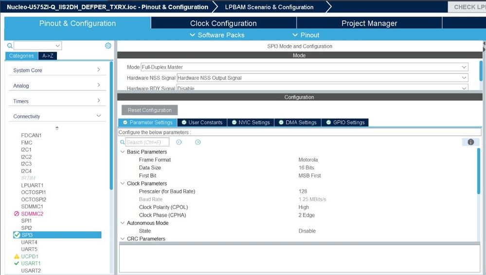

I don't have an oscilloscope to read the signals on the other board, so I can't really see what is going on, but the codes and configuration are exactly the same on both boards. Here are the SPI configurations:
I noticed the readings for the device ID and acceleration data are always 255. When I put my hand closer to the wires, the ID reading oscillates between 0, 51 and 255. I believe the value 51 indicates that the communication is being done correctly, but there is too much interference. I tried reducing the baud rate, but this didn't solve my issue. I am using 5cm jumper wires and my board is being fed through the USB port.
Do you know if there is some other configuration that would cause this interference on the signals? Are there any known issues or quirks with the SPI peripheral on the Nucleo boards that might affect communication with this type of sensor? Are there any specific tests or diagnostics that can be performed to isolate and identify the source of the interference?
