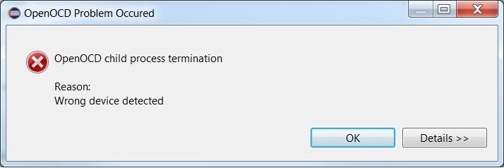

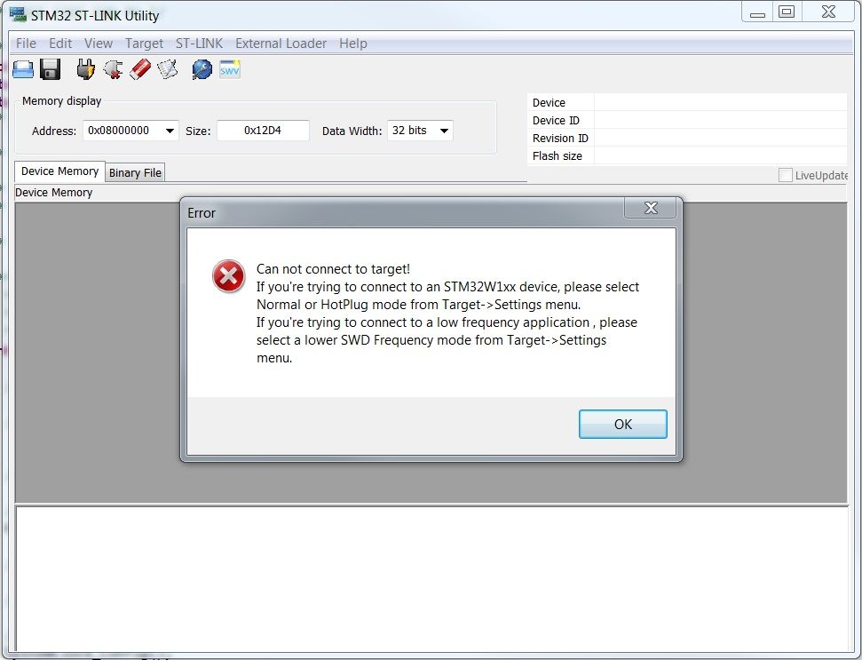

My system is Windows 7 and error is so:
and with SW4STM32 IDE, i have this error:
