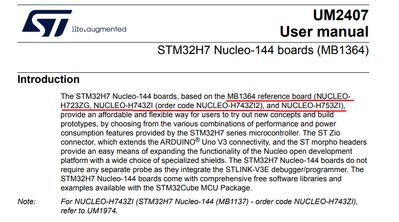

Hello @sidney ,
UM2407 applies to NUCLEOH723ZG, NUCLEO-H743ZI and NUCLEO-H753ZI as stated in the introduction
H723, H743 and H753 have separated PF0, PH0, PF1 and PH1 pins. The HSE crystal is on PH0 and BH1
I will check internally and get back to you as soon as I have an answer.
