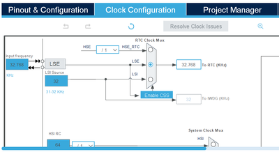

Thank you very much for the information.
As you mentioned, I agree with you. By not using alarms, the PC13 pin IS NOT AFFECTED. I have checked the configuration and had to activate the 32.768 KHz external clock source (as shown in the image). I have now tested it and NOTICED THAT IT WORKS VERY WELL.
Thanks for your help.
