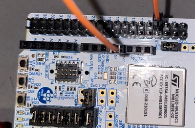

I unfortunately have already tried this and i cant seem to connect still :
However, i don't think it ever enters bootloader mode as the lights are unchanged. Do you have any other suggestions?
The program currently loaded on the module is just a simple ADC program. No low power or flash usage has been incorporated as of yet.
