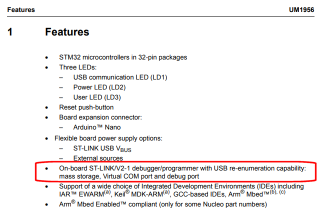

So you are using a Nucleo-32 board?
"ST-Link" is the programmer/debugger built into the Nucleo board:
More details in section 6.3 of the User Manual (UM1956).

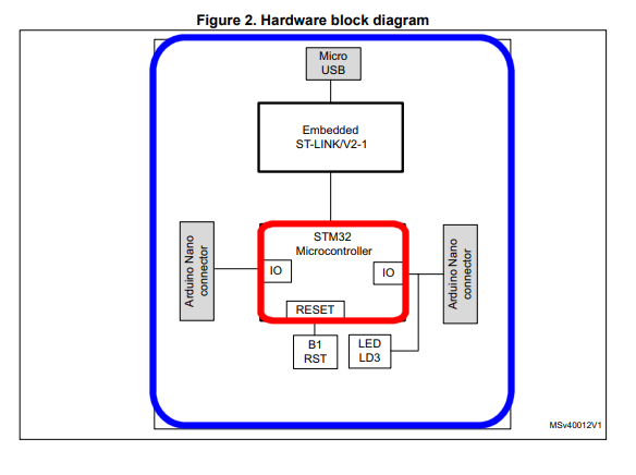

@a1rWAXTA wrote:Why in alternate function table, it is shown that PA3 can be mapped to USART_RX
That's a function of the chip - irrespective of what board it's mounted on.
@a1rWAXTA wrote:but here is written that PA15 is connected to ST-LINK.
That's about the wiring on the board - which is external to the chip.
EDIT:
The chip is highlighted in red; the board in blue:
Note how the board is providing connections from the chip (the STM32 microntroller) to the Button, the LED, and the ST-Link.

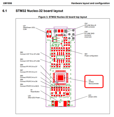

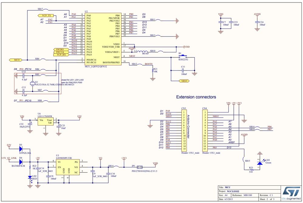

Could you please explain me this schematic? What is the part U2 and what is Extension connectors? PAx are MCU's pins and they can be assigned to various alternate functions but I'm limited to those what board realize, right? A3, D3 etc. mean analog pin, and digital pin (in/out) respectively, don't they? And hence I can assign (in cubemx) only those functions pointed on the schematic, even though cube allows me to assign other functions (for whatever reason?). For example PA15 can be only mapped to usart, and can't be mapped to general purpose input and PA3 is analog input/output? Do I understand it correct?
2024-06-26 11:01 AM
@a1rWAXTA wrote:Could you please explain me this schematic? What is the part U2
That is the STM32F303K8 microcontroller:

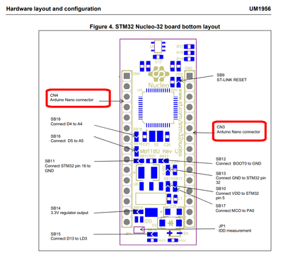

@a1rWAXTA wrote:what is Extension connectors?
Those are the 2 rows of pins on the sides of the Nucleo board - marked as "Arduino Nano connectors" in the UM:
@a1rWAXTA wrote:A3, D3 etc. mean analog pin, and digital pin (in/out) respectively, don't they?
Those are the standard functions assigned in the Arduino Nano pinout - but the pins aren't restricted to just those functions.
