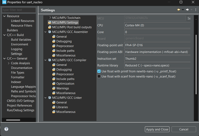

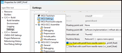

I’m not sure if it’s relevant, but I also have this option enabled (which I’ve seen suggested as a solution in other explanations online

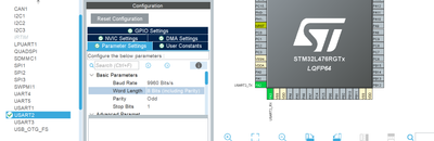

Check your baudrate, data lenght, stop bit parity etc .. these parameters needs to match your hyperterminal.
For example set these configs to the USART2:
UartHandle.Init.BaudRate = 9600;
UartHandle.Init.WordLength = UART_WORDLENGTH_8B;
UartHandle.Init.StopBits = UART_STOPBITS_1;
UartHandle.Init.Parity = UART_PARITY_ODD;
UartHandle.Init.HwFlowCtl = UART_HWCONTROL_NONE;
UartHandle.Init.Mode = UART_MODE_TX;

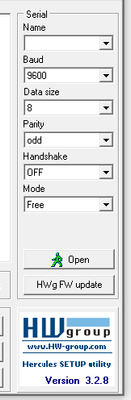

Use Hercule utility for example and set these configs:
Don't forget to set the correct COM port.

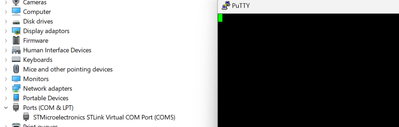

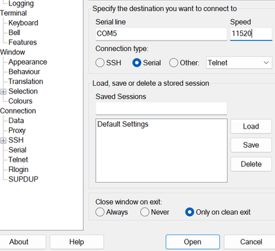

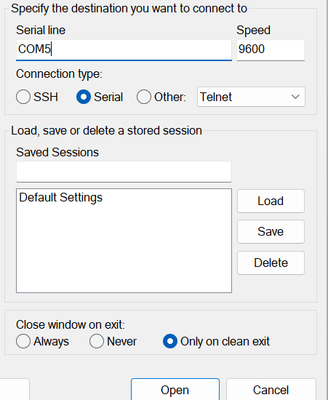

2025-04-07 1:50 AM
No matter if I set these parameters:
I get the same result in both STM console
or putty:
the same will be for the other parameters:

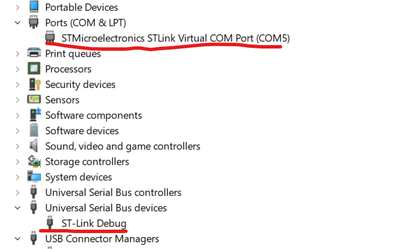

maybe its the case with the connection in the device manager with usb or smth, I dont know:

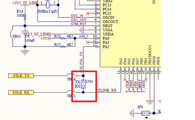

Fit a jumper on CN3 to loopback the Tx and Rx of the VCP. Send a character on the HyperTerminal and see if you receive it:
This test is to validate the HyperTerminal parameters, your PC/board connections, and the VCP.
