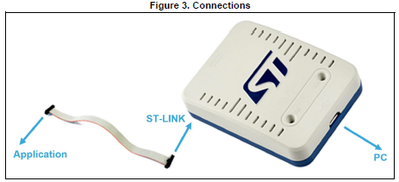

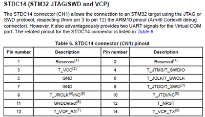

I also purchased a STLINK-V3SET debugger/programmer for STM8 and STM32. But unfortunately, Nucleo-L476RG does not have a standard connect that mates directly with the STLINK-V3SET 14 pin JTAG/SWD connector. The STLINK-V3SET even comes with a 14-pin flat ribbon cable, but there's no place to plug it into the Nucleo-L476RG. I'll have to make a custom cable or use individual flying leads. Maybe next time.
