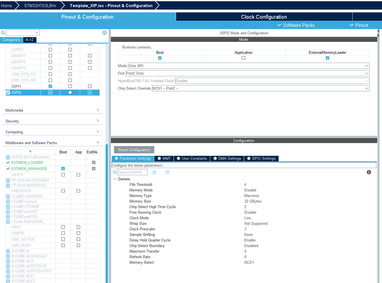

I have a Nucelo-H7S3L8 board running the demo application. The project has 2 applications (boot, and application). The boot is supposed to jump to the application, which is located in the external MX25UM25645GXDI00 memory.
However when debugging the boot application the BOOT_Application() function returns "BOOT_ERROR_MAPPEDMODEFAIL". My configuration for the MX25UM25645GXDI00 is attached to this post.
Any hints or guidance will be greatly appreciated.

2024-04-15 1:15 PM
Hi Kaouthar,
Thanks for your replay.
I have had a chance to match my settings in the ioc file with the "Template_XIP" ioc settings. Unfortunately, I have had no luck with my problem. I am debugging the external memory with the "ExtMem_manager" application but no luck.

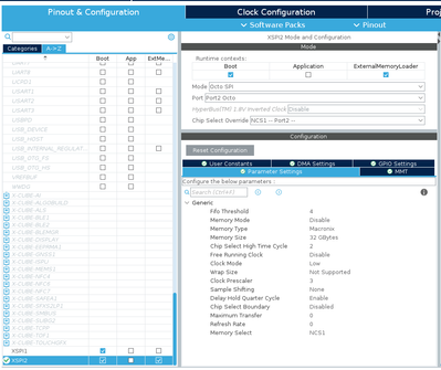

The state gets set to 512 somehow. I have not had time to debug this further, but I know that state is NOT valid after the init function MX_EXTMEM_MANAGER_Init()

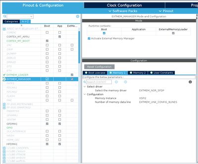

@KDJEM.1I just made a new project for the Nucleo-H7S3L8 board. Below is how everything is configured. I have not changed anything.
Thank you for the help.

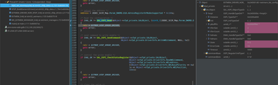

2024-04-17 10:23 AM

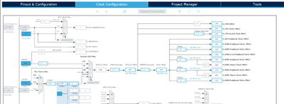

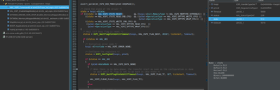

@Malvi2024I just had a little debugging session and I found out that the invalid state is set at this point:
inside the HAL_XSPI_Read() function there is a XSPI_Command() followed by XSPI_Recieve(). The recieve function seems to timeout.
Here is my clock config.
Not sure, how to move forwards.
Thanks for the help guys.

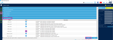

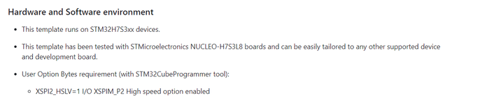

2024-04-18 7:28 AM - edited 2024-04-18 7:44 AM
Hello @bashira, @Malvi2024 and @atosun ,
Thank you for this clarification.
Could you please try to use the STM32CubeProgrammer to check the value of XSPI2-HSLV option byte.
To achieve higher frequency the XSPI2-HSLV must be "Checked" as mentioned in the readme.
Please let me know if the issue is solved or not.

2024-04-18 7:47 AM
Hi Kaouthar,
That definitely seemed to have solved the problem for me. I will do some intensive testing later on.
Thank you very much for the help :)
