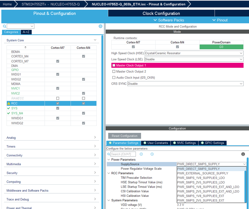

For the Nucleo-H755ZI, I use the 'PWR_DIRECT_SMPS_SUPPLY' choice in 'HAL_PWREx_ConfigSupply', like:
HAL_PWREx_ConfigSupply(PWR_DIRECT_SMPS_SUPPLY);
With this setting, the board works fine and keeps working after flashing.
If you choose for example 'PWR_LDO_SUPPLY', you would next un-brick your board, using STM32CubeProgrammer, selecting Mode 'Power Down' and erasing the chip.
That way you can flash it again within STM32CubeIDE, after correcting the power setting.
Since I can't find the 'PWR_DIRECT_SMPS_SUPPLY' option in STM32CubeMX, I always need to modify it manually.
In STM32CubeMX I only find these settings:
- PWR_LDO_SUPPLY
- PWR_EXTERNAL_SOURCE_SUPPLY
- PWR_SMPS_1V8_SUPPLIES_LDO
- PWR_SMPS_2V5_SUPPLIES_LDO
- PWR_SMPS_1V8_SUPPLIES_EXT_AND_LDO
- PWR_SMPS_2V5_SUPPLIES_EXT_AND_LDO
It seems I'm missing
- PWR_DIRECT_SMPS_SUPPLY
Do I overlook some other setting?

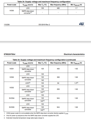

This is a normal behavior, as you are using a core frequency above 400 MHz, which requires the use of the LDO and pushes "PWR_DIRECT_SMPS_SUPPLY" option disappear.
You can refer to the STM32H755 datasheet and check the Table 24. Supply voltage and maximum frequency configuration:
So, reduce the core frequency to 400 MHz, then keep me informed about your update.

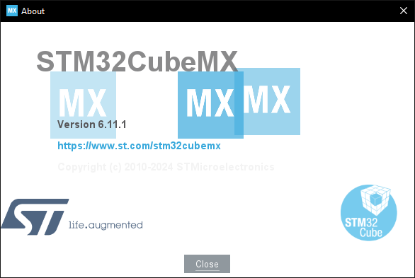

Make sure to update and use the latest release of STM32CubeMX v6.11.1.
The "PWR_DIRECT_SMPS_SUPPLY" option is available with STM32CubeMX v6.11.1.

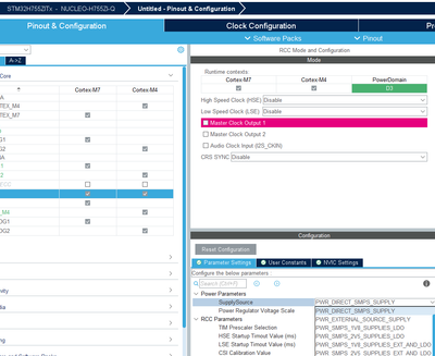

Hi Imen, thanks for the quick repsonse!
I forgot to mention I'm using STM32CubeMX v6.11.1.
Somehow it's not in my STM32CubeMX v6.11.1.

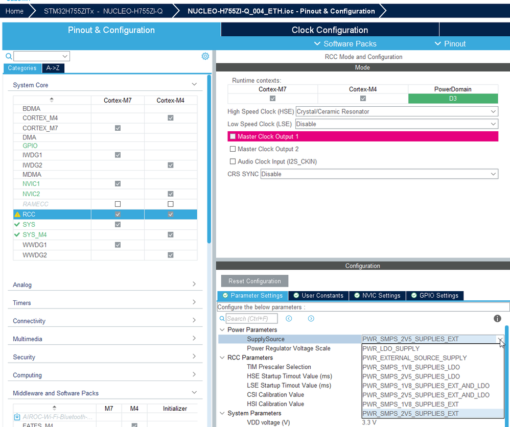

Hi Imen,
thnak you very much, I deleted the old CubeMX versions, and use the latest version.
I now attached the ioc file.

Hi Imen, I can confirm this was the issue.
Though I was alway able to adjust it outside of STM32CubeMX and then everything worked just fine.
I see the voltage should be 1.7V instead of 1.62V, indeed.
Perhaps I should run the board no higher than 400MHz to avoid issues.
