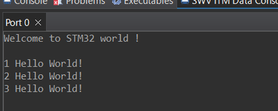

2025-11-14 5:10 AM
This is to use a printf over the serial wire viewer
You can refer to this article: Using the ITM console for printf redirects and LWIP debug messages

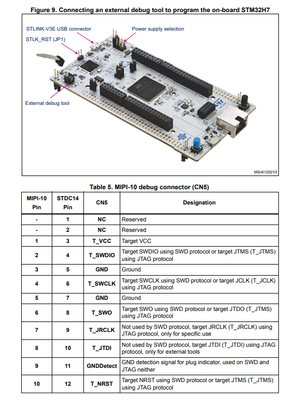

I had debugged my Nucleo board with the J Link with the segger RTT. Now i like to change to STLINK So l would like to know what version of ST external debuger support my board which can be used for debuging my device
2025-11-14 3:53 AM - edited 2025-11-14 3:55 AM
You can connect a J-LINK on CN5 connector on NUCLEO H753ZI:
Please refer to the user manual of the board UM2407 / section 7.3.3 Using an external debug tool to program and debug the on-board STM32H7
For STLINK you can use the external version STLINK-V3 (I don't know what the reason to use an external version while there is one on board)
Hope that does answer your question

2025-11-14 5:04 AM
2025-11-14 5:10 AM
2025-11-14 6:39 AM
@JhonVijay wrote:i had tried to debug using the internal debugger to print the debugging messages by refering this vedio but i couldn't see the any debug messages
But you could load your code OK, and use other debugger features like stepping, breakpoints, examining variables, etc?
As @mƎALLEm said, that video is about using SWV.
You can also get debug messages from a UART via the ST-Link's VCP (Virtual COM Port) ...
