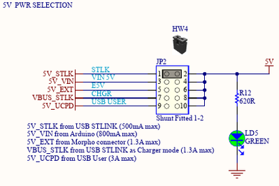

I just set jumper JP2 : stlink+chgr+usb_user , so with debug USB all is working.
look in circuit:

So, to make sure I understand correctly - I already have JP2 in the STLK position, do I have to add 2 more jumpers, in the CHGR and USB_USER positions? I was under the impression that only one jumper is allowed at one moment, since JP2 is the power source selector for the board?
2024-03-02 9:46 AM
With the jumpers JP2 you decide, what to connect to 5V .
I needed 5V with max. power at the USB_USER for connecting sound card; if you want same, need 3 jumpers.
if not sure, just look at the circuit, there you see, what you connect.

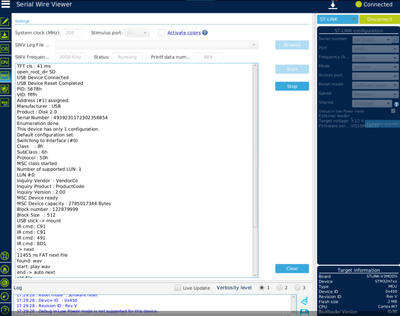

2024-03-03 1:13 AM - edited 2024-03-03 1:17 AM
What i would do: try to see the debug messages...
You have SWD running ? then can see , what the USB telling , like here on usb stick inserted:
(here in cubeProgrammer , but same in IDE -> swv data console )
--- or you use the vcp serial, on H563-nucleo board already connected also.
