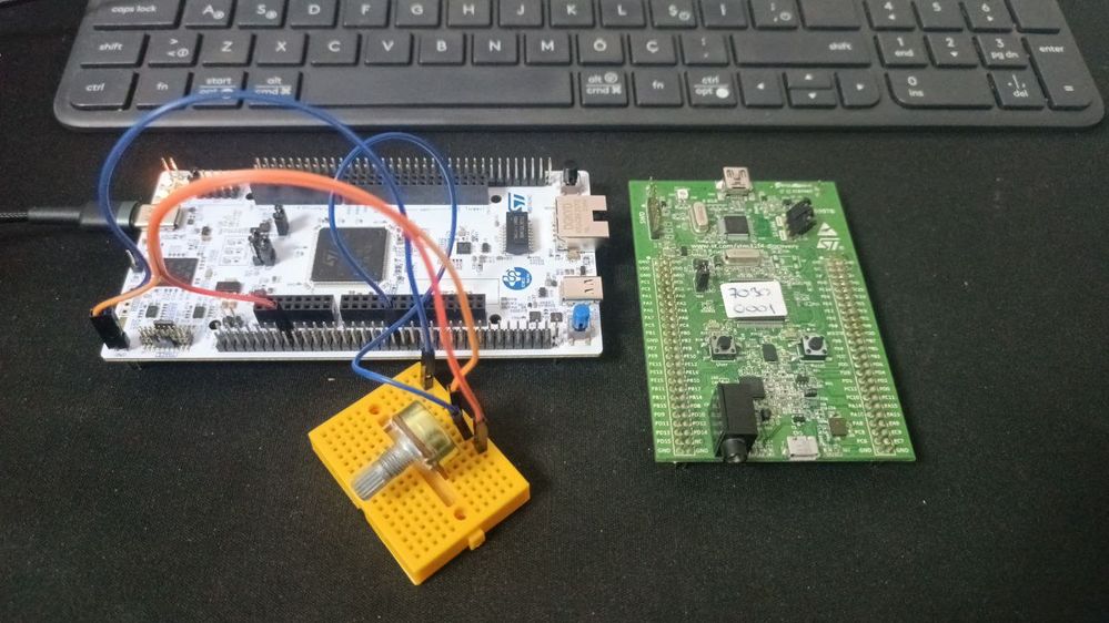

Which Discovery board - I don't see an H563 Discovery ?
Showing photos of both setups could help ...

So that's an STM32F4-Discovery - very different to an STM32H563 !
And, as has been said by many, long wires and breadboards are very prone to picking up interference

How is this setup grounding the pin exactly? Jumper from the pin to GND directly. Looks like it's connected to a potentiometer, not grounded.
2025-10-27 12:07 PM
I'm getting the ground connection directly from the board. There are no problems with the connections. Long cables don't cause any problems on the Discovery board. I don't think it's the cable either. Do you have any real suggestions for a solution?

Meanwhile, you didn't confirm which discovery you are using: STM32F4-Discoevery or STM32H573I-DK there is is big difference between both: note the same product, not the same architecture, not even the same ADC!
Another hypothesis, it could be due to the Ethernet PHY on the Nucleo board.
Read this article: ADC value affected by ETH PHY 50 MHz from RMII interface
From my side, I tested the following channels:
- CH10 (PC0): worst case 5LSB
- CH3 (PA6): worst case 2LSB
- CH2 (PF11): worst case 2LSB
- CH6 (PF12): worst case 2LSB
So try channels far from ethernet signals. Try for example: CH6 (PF12).
Attached the project I used for my tests. If you are still getting 40LSB, you need to remove all the non needed stuff including the potentiometer that we are seeing in the photo and keep only one wire to ground the ADC. Please use short wire.
