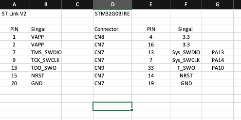

I have the device wired up as follows:

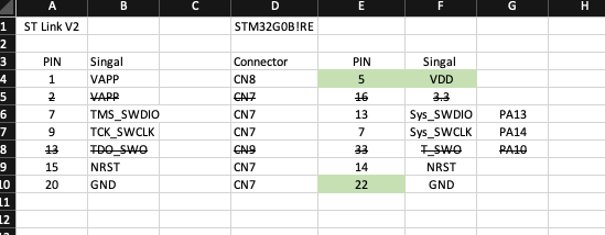

2023-01-30 11:32 AM
got it working, thanks all!
2023-01-30 12:41 PM
The pin 1 of the ST-LINK should not be 5V, but rather the voltage of the Target, so either 3.3 or 3V typically.
