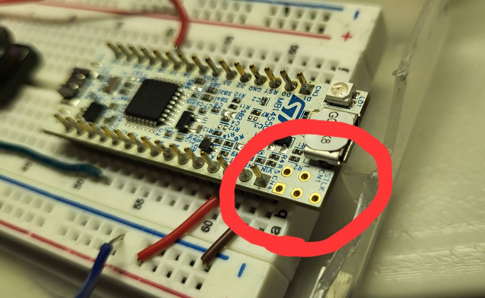

Does anyone know the exact pin-out of these five pins? I cant find anything in the documentation. Hoping it will allow me to use an external programmer.

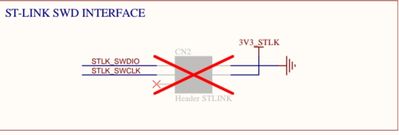

Hello @Bcarpneter5 and welcome to the ST Community :smiling_face_with_smiling_eyes:.
According to the schematic MB1455 this is a 5 pads for ST-LINK SWD interface and it is Not fitted.
Best Regards.
STTwo-32

2024-01-21 2:20 PM
It is the SWD access to the interface STM32F103, Find it as CN2 in the Nucleo32 schematics.
2024-01-21 2:29 PM
Thanks Everyone This Helped allot so the pin out is as following
GND , 3.3v
SWDIO , SWCLK , pin for holding the connector in place
