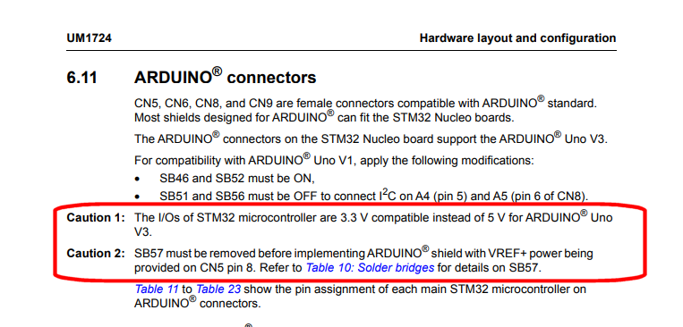

The first thing to note is that Nucleo boards operate at 3V:
so you first need to check that your shield works at 3V - not 5V.
Next you will need the schematic for the shield, so you can tell how all its components are connected to the STM32.
You will also need the User Manual and schematics for the Nucleo board - available on its Product Page:

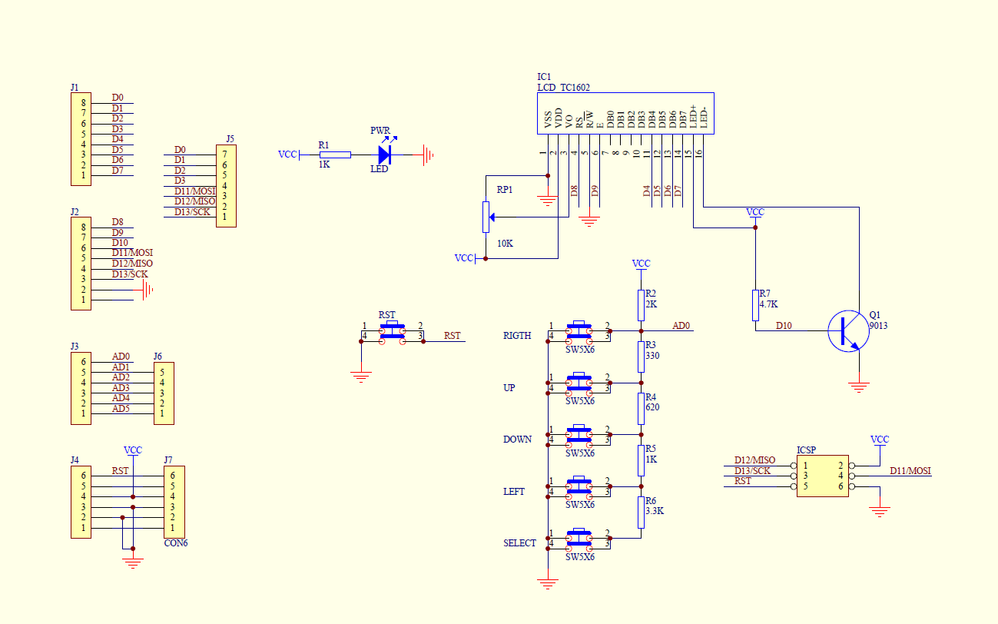

Clone of "SainSmart 1602 LCD Keypad Shield V3"
https://www.sainsmart.com/products/uno-1602-lcd-keypad-shield
https://wiki.dfrobot.com/LCD_KeyPad_Shield_For_Arduino_SKU__DFR0009
Schematic here? The 5V analog for the buttons might be problematic
https://forum.arduino.cc/t/lcd-keypad-shield-for-arduino-lcd-1602-wiring-by-botton-side/177192
