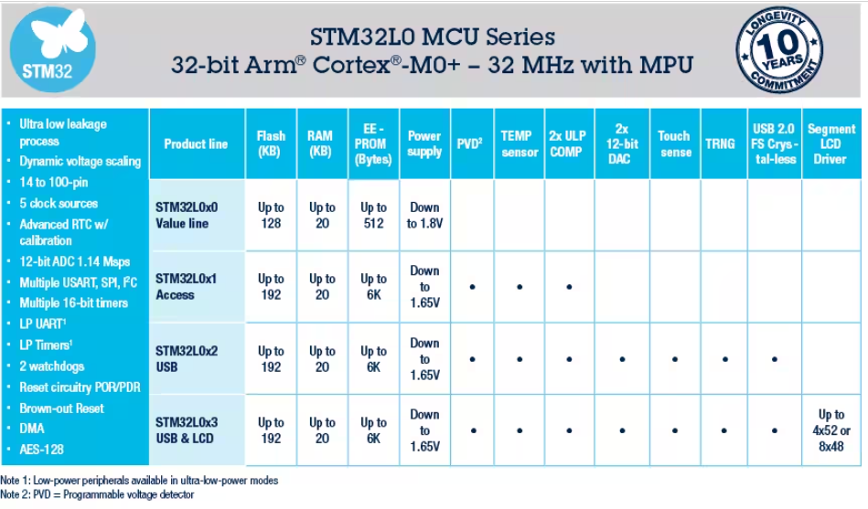

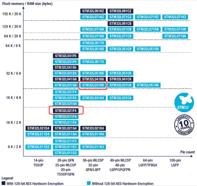

@Sisto Zànier - read about the 'Access Line' parts here:
https://www.st.com/en/microcontrollers-microprocessors/stm32l0x1.html
The differences between the family members are in numbers of pins, amounts of memory, and presence/absence of the hardware encryption
I've highlighted your L031K6 and L021F4:
