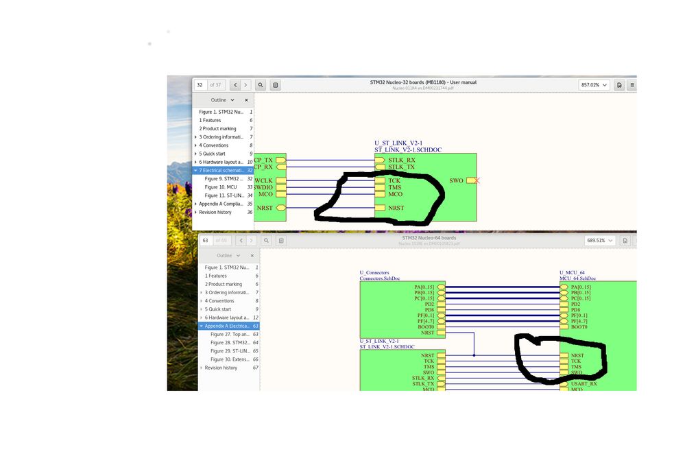

is it ? here's the schematic I saw
2019-02-21 4:45 AM
Yeah, the ST-Link is directly connected to the on-bard MCU, without jumpers to route it to a SWD connector.

from schematic I can see a possibility using Nucleo 32 for external debugger , any clues ?

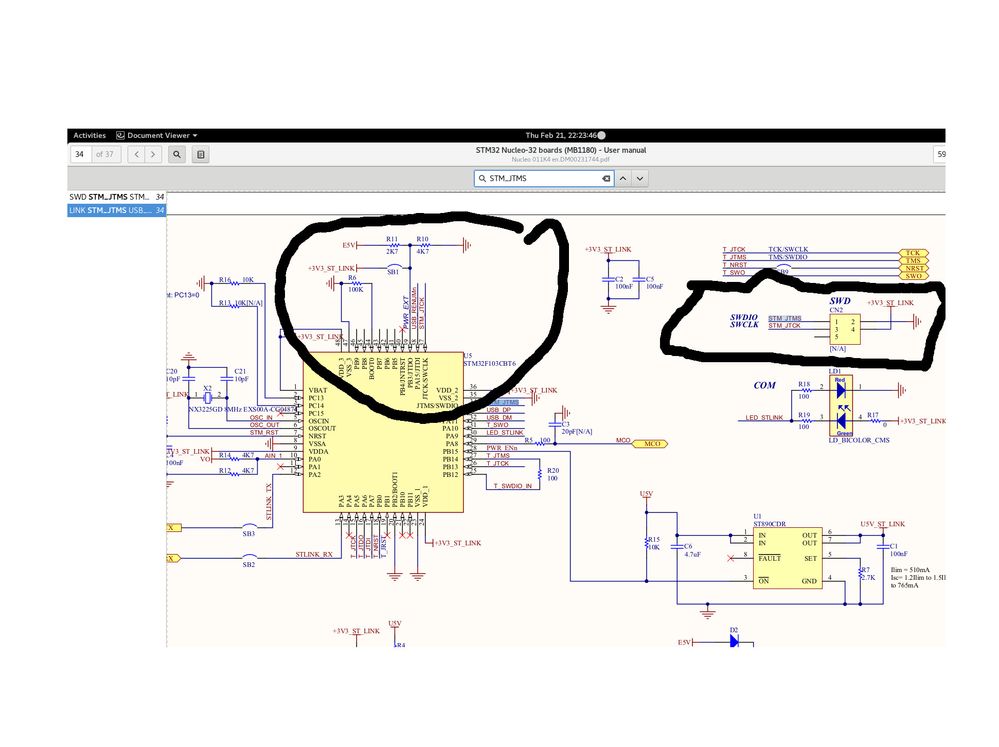

That's from Nucleo 32 Schematic, I should be able to use SWDIO , SWCLK and NRST for programming external board, if it can not , probably a software compatibility ??

But you can still try to cut the PCB tracks, and add your own connector.
Or get another Nucleo board with solder bridges.
