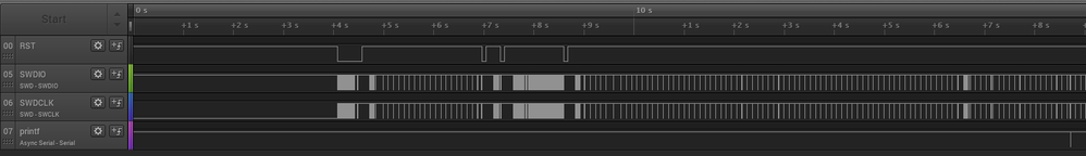

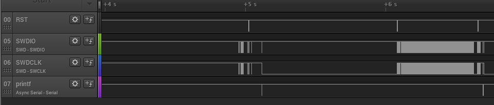

I've tried with OpenOCD. This looks better!
OpenOCD:
ST Link GDB:
I think it first checks the chip type before actually doing anything, and because it launches the debugger twice for that it can't hold reset.
It can be annoying locking up i2c devices and such because it gets resets again so quickly.
