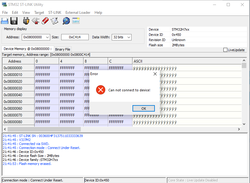

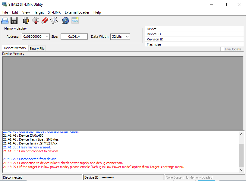

}I tried to erase the flash memory using ST-Link to re-flash the code but i encountered something like this,

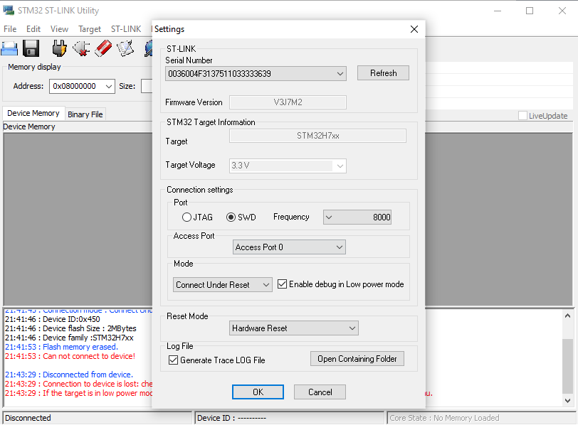

The settings in ST-Link Utility is
