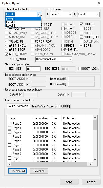

I tried to set the read protection to level 1 (the one where we should be able to wipe out everything) .

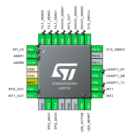

I was thinking that maybe some debug port pins changed function, but why would this change with only setting a read protection bit?

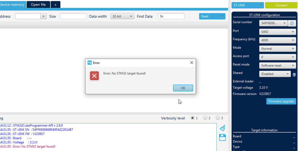

What does this mean? What specific error message do you get when you try to connect with STM32CubeProgrammer? Does it show target voltage?

this is the error in IDE
Error in final launch sequence:
Failed to start GDB server
Error in initializing ST-LINK device.
Reason: (4) No device found on target.With the programmer

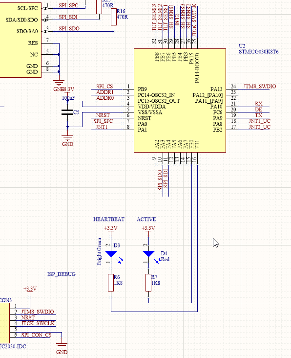

Did you reassign SWD pins? Might try to connect under reset. Verify power rails and current draw is as expected. Seems like a hardware issue somewhere, check for loose connections, poor soldering.
