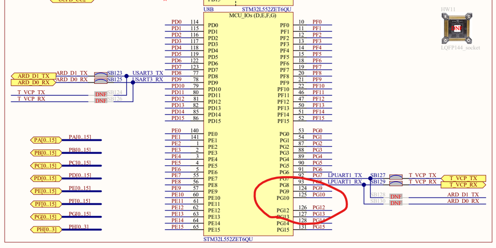

I need to use the SPI on port G which requires PG11 for SPI MOSI.
However in the schematic for the board, PG11 is missing from the schematic symbol (see page 3) and there is a gap. The pin numbers in the symbol keep incrementing though.

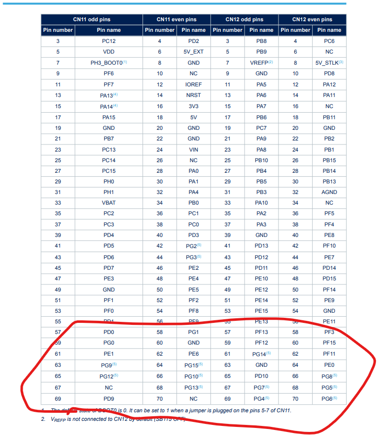

PG11 is also missing from the Nucleo Pinout table (page 39).

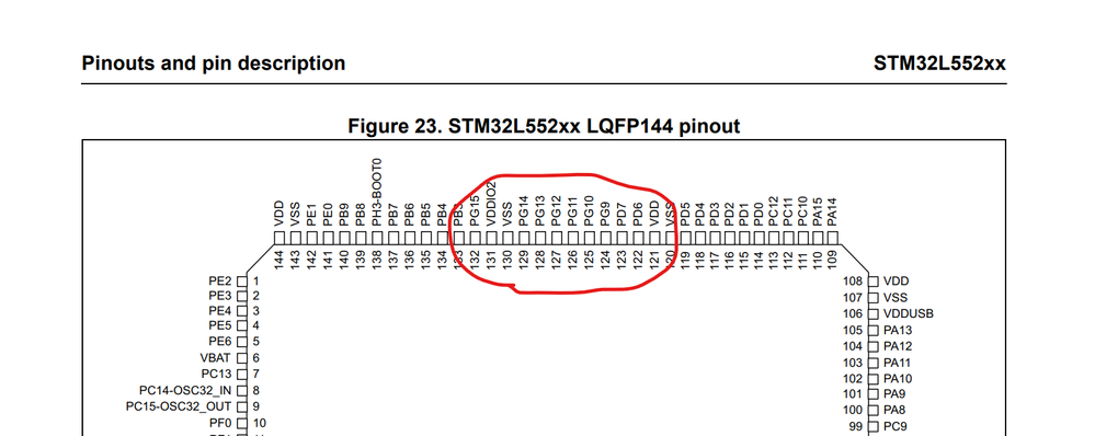

In the STM32L552xx datasheet (page 86), PG11 is assigned 126.

Same Data Sheet, different page
Not sure of the SPI options on GPIOG. If other option aren't available you'll need to bit-bang the interface.

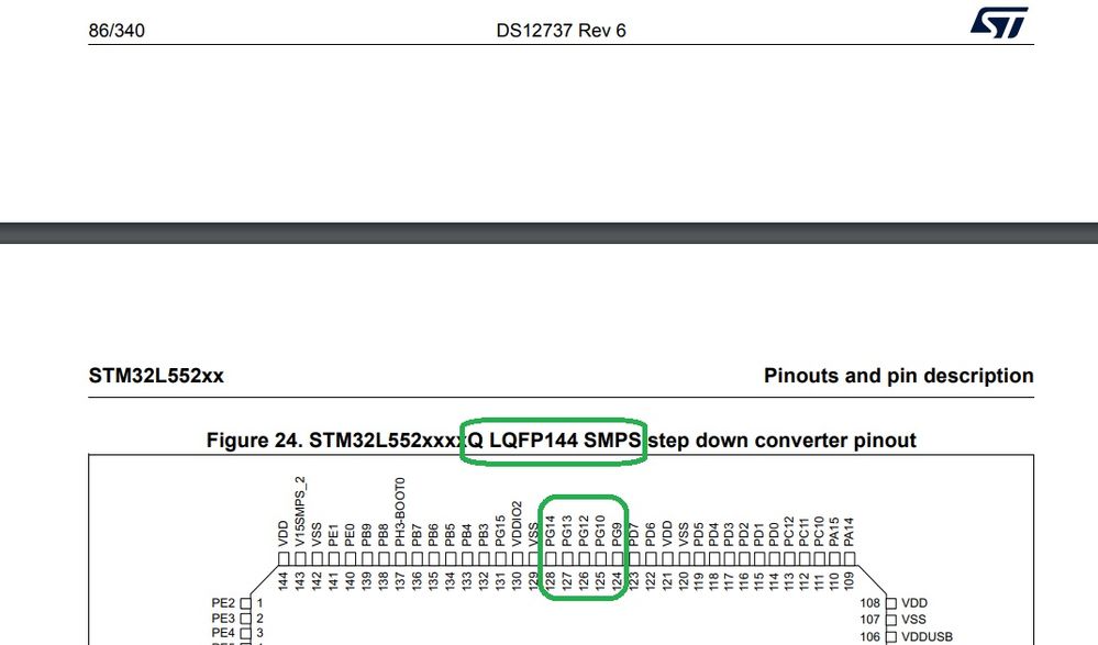

You need to look at the -Q (SMPS) device, it's apt to have moved the pins around.
You're looking / comparing the Wrong part. The Q parts cause all manner of pin compatibility headaches

I see your point about the Q part and that I was looking at the wrong datasheet. Many Thanks.
Does this mean that the PG11 pin isn't accessible in the Q package? Or is there another way to access the SPI MOSI on Port G?
