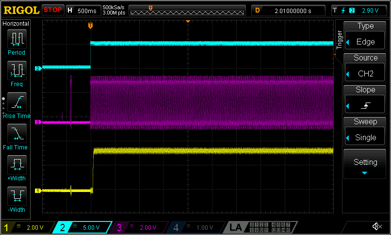

Nucleo-F446RE power from E5V
it takes a long time to "boot" or start to execute code. some code will never start running. the problem goes away if the ST-Link is power from USB before E5V is turn on
I have captured the problem on the scope. The MCO clock from ST-Link stops for about 2sek when power from E5V.
Nucleo-F446RE power from E5V ST-Link FW V2.J37.M26
Blu E5V
Yellow T_NRST
Pink MCO

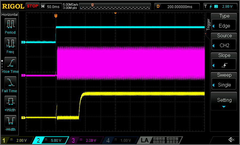

Nucleo-F446RE power from USB ST-Link FW V2.J37.M26
Blu E5V
Yellow T_NRST
Pink MCO

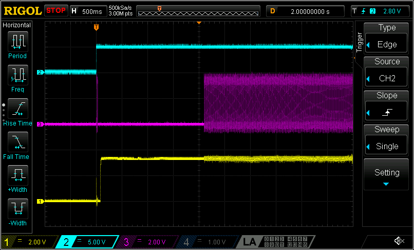

Nucleo-F446RE power from E5V ST-Link FW V2.J34.M25
Blu E5V
Yellow T_NRST
Pink MCO
Note the the time division is different

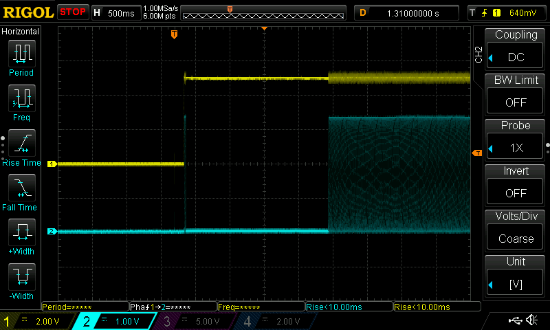

2025-02-15 9:46 PM
Nearly 5 years on and the same problem still persists!
This is a Nucleo F446RE development board with the STLINK/V2.1 interface.
The firmware is V2J45M30.
Yellow = E5V
Blue = MCO output from STLINK/V2.1
The problem can be solved by choosing HSI instead of HSE, however, my application relies on accurate timing and HSI has great variations which make is useless for my application.
The obvious solution is to fit X3 and associated components but that completely defeats the purpose of having a crystal derived [accurate] MCO available without any additional components.
