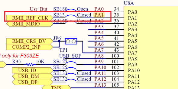

I've already suggested to check the schematics
"You need to check first what is connected to each channels? did you check the board schematics? "

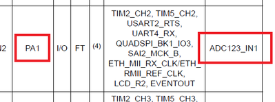

From the datasheet: ADC123_IN1 corresponds to PA1.
and according to the board schematics, PA1 is connected to RMII_REF_CLK!
You need free IOs to measure an external voltage.
That's why you need always to check the schematics before using a board.

PA1 should not be used in this board as ADC input. RMII_REF_CLK is also injected to the ADC input according to the boards schematics I shared above. So need to use another GPIO.

Please review the schematics.
You can't use PA1 unless you remove the solder bridge SB13 to disconnect RMII_REF_CLK. SB13 is closed by default.
