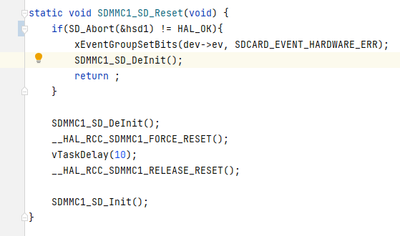

Then I changed the driver code to seem to have solved the problem, and restarted the code by adding abort before deinit and init.

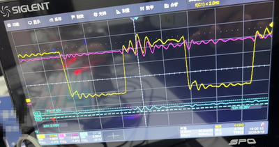

1、Why does the SD card often malfunction? Is it caused by the clock waveform? Is this waveform setting incorrect for DPSM?
I adjusted the frequency to 4M, but the Voltage overshoot was very large.
Yellow represents CK and pink represents 3.3V voltage
2、I used a soft restart for the SD card, but it seems to be of no use. Is there a way to solve the problem of the SDMMC getting stuck at a certain state due to being stuck at the DPSM?
If the abort continues, it will cause the IDMA to step on other stack Spaces, thereby resulting in a hardfault.So if abort fails once, I won't use the SD card anymore.

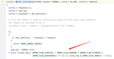

When there is a problem with the SD card, it will keep waiting for the flag bit. The same is true of reinitialization
