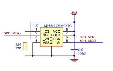

schematic for reference:

2020-06-22 12:26 PM
Chip select managed where?
2020-06-24 7:11 AM
Chip Select is Connected to Ground.
2020-07-01 5:04 AM
Hello
/CS must be with pull-up & managed by the µc.
If always connected to GND, the device can be selected. That's why you read always 0xFF.
See datasheet section 3.4 here : https://www.st.com/resource/en/datasheet/m95512-w.pdf
BR
Team EEPROM suPPort
2020-07-02 7:42 PM
Hi, I'm using only one slave on spi channel . So, is that wrong to keep pull down by default?
Thanks,
Pratheep
2020-07-03 12:37 AM
/CS=1 means eeprom deselected.
To select the eeprom, you must pass /CS=1 to /CS=0 before starting communication. The transition high to low is mandatory.
If you always keep /CS=0 , you can't have communication master vs eeprom.
2020-07-06 1:19 AM
Thank you!
