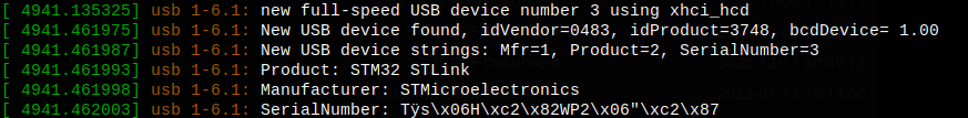

after plug st-link to a usb, you should see on dmesg output:
If nothing - take another cable+port , if on not-just-charger cable no st-link found . its defective.

I get most of that output, but after the manufacturer details I get "can't set config #1, error -32". I will try this on a different laptop and get back to you later today.
