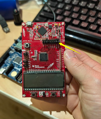

TI does a nice job of putting a DMZ between the debugger/programmer and the MCU and adding jumpers on every line that crosses the DMZ so you can visually verify air-gap for evaluation.
If anyone at ST is listening, this would be a great feature on future boards. :)

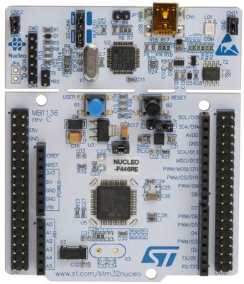

NUCLEO-F446RE
