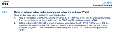

for U5 nucleo144 board, see user manual:
