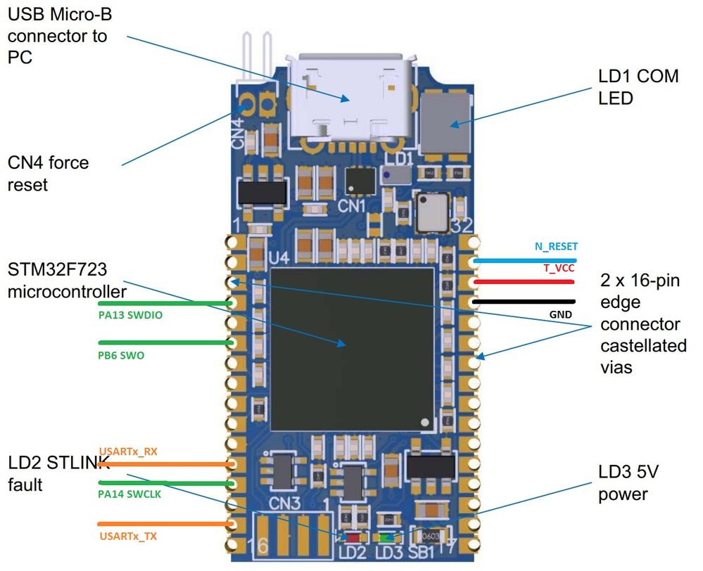

I want to use the Virtual Com port and also do debugging. The fact that the STDC14 handles three protocols JTAG/SWD and VCP doesn't really tell me which pin would go where on some example STM32 board. For example, if I broke off the ST-Link V2 part from a Nucleo64 board, What pins should I use to then connect the ST-Link V3 mini?

Thanks for answering Clive. That is interesting, but not really what I am looking for. That looks like some detail of what pins on the edge of the V3 mini go to the embedded STM32F23. Right?
And certainly, I have looked at the User Manual for the V3 before I did the post, and I see the STDC14 connector and it's pinout, but that still doesn't tell me exactly how to connect those pins on the connector to an STM32 board. I really mean I would like to know the detail of what pin on the STDC14 connector goes to what pin on the STM32 that I want to connect to. There a plenty of examples around for the V2 and for debuggers like the Atmel ICE, but not for the V3.

Ok, it's not that complicated
On STM32's you have
PA13 = SWDIO
PA14 = SWCLK
PB3 = SWO
NRST/NRESET
T_VCC is the Target's VCC
have a common GND
