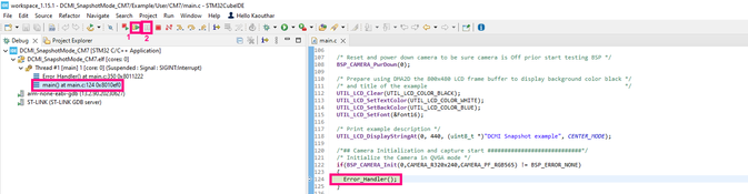

Hello @syrine and welcome to the community :),
For the warning issue could you please try with the last version of STM32CubeIDE.
If you click on resume then suspend as shown in the below figure, do you get an Error_Handler()?
Thank you.
Kaouthar

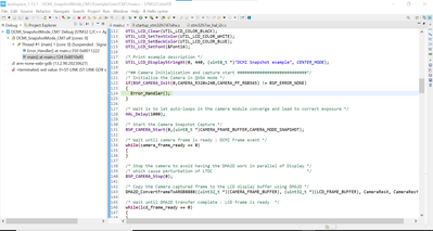

Good morning ,
yes , there is this error :

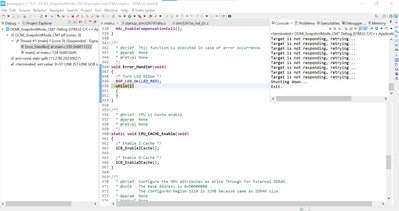

2024-08-05 2:55 AM
