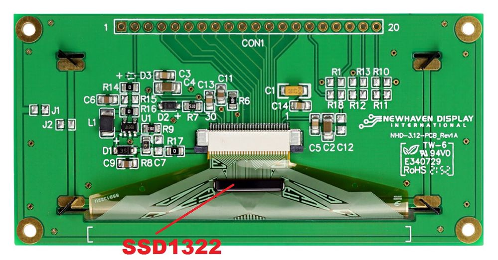

Sir, i have some questions. NHD 3.12 25664 and SSD1322 both are same display? actually i am trying on STM32F411 with NHD 3.12. Please help me and guide me!!
2024-05-25 11:18 AM - edited 2024-05-25 11:23 AM
The NHD 3.12 25664 uses an SSD1322. It's usually a bare IC mounted on the flex cable, converting the MCU Interface into pixel drivers for the display in a rows and columns fashion.
