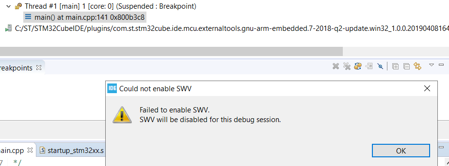

is it possible to run debug session by connecting to already running ST-LINK GDB server in STM32CubeIDE? The gdb server is executed by this command: ST-LINK_gdbserver.exe and "-c config.txt" parameters, where the content of "cinfig.txt" file is:
I receive this error message:

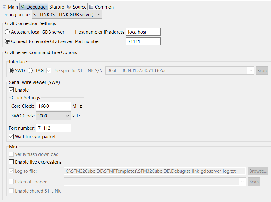

My debug configuration:
Is it possible to enable SVW trace?
