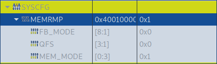

The issue gets more transparent during the call to __HAL_RCC_SYSCFG_CLK_ENABLE(); in the file stm32l4xx_hal_msp.c since then the MEM_MODE is changed to 0x01 in the SYSCFG-MEMRMP register.
After a while (IRQ?), the code execution in the debugger jumps to the address range above 0x1FF00000 and I have to restart the debugger to come to the reset vector of my code. (Makes sense since the VTOR base address is not 0x0 anymore.

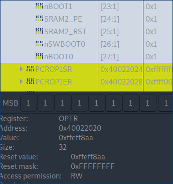

Does any one know, if enabling the octospi interface in STM32CubeMX might change something in the binary which affects the used memory mapping mode even before the reset vector? Since the boot0 pin is kept low and the FLASH_OPTR register is still at default value I am not sure what could affect the SYSCFG-MEMRMP register.

I modified now the file startup_stm32l4r5zitx.s to reset SYSCFG_MEMRMP to 0 and SCB->VTOR to 0 as recommended in the post above.
As described there it brings me a small step forward. But as soon as I am resetting the target from the STM32CubeIDE the MEM_MODE is changed again.
