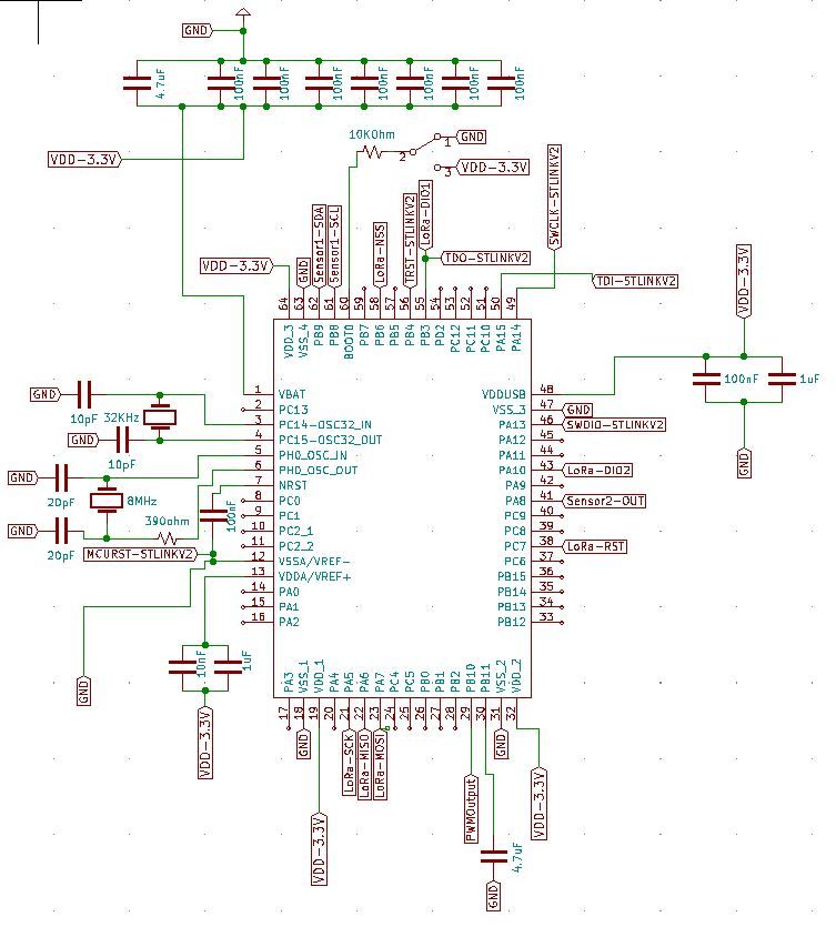

Hi, Peter! I have done the schematic of the MCU which is supposed to be mounted on an external PCB. I've mentioned the required connection pins of MCU with an external ST-LINK V2. Can you verify it once and let me know whether it is a go for fabrication or not?
0693W00000FApd4QAD.jpgFirst, let me know whether it is correct or not then we can proceed to the conclusion.

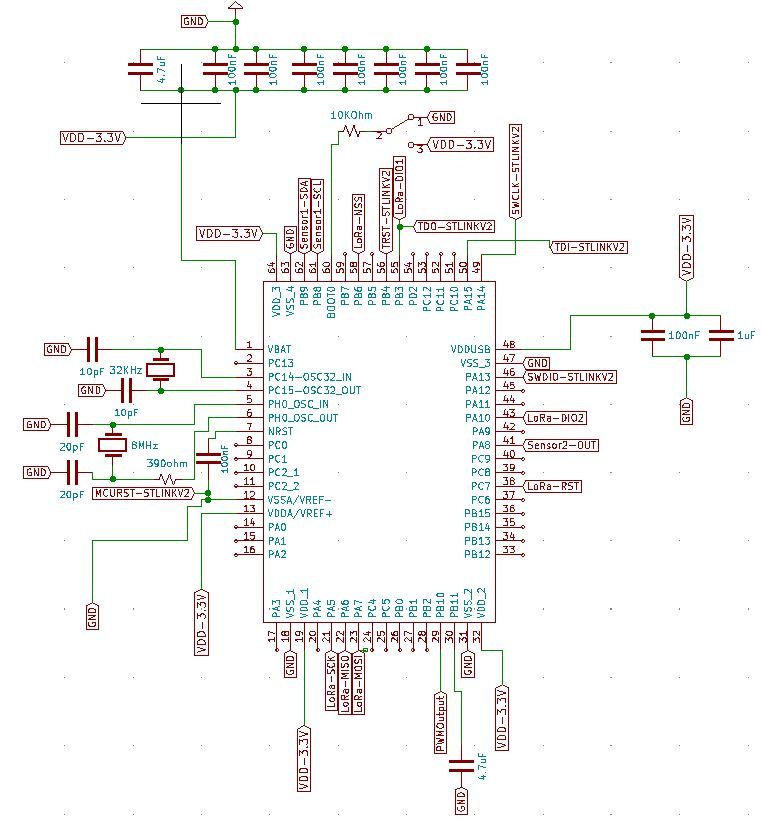

Thank you very much. 0693W00000FApk5QAD.jpgCan you please have an eye on this? Now it is connected with ST-LINK V2, will it work? If yes. I can try it on connecting with the ADD NUCLEO Board (where MCU is cut).
ONadr.1
Senior III
I notice, the VDDA/VREF+ is not is not connected. Only blocked by capacitors.
0693W00000FAptWQAT.jpgThank you !
Modified, rest all ok?

NRST is connected to MCURST of ST-LINK V2 and altogether it is grounded. Is it ok?
ONadr.1
Senior III
NRST should be connected to VDD via cca 10k rezistor. No capacitor needed. STLINK reset pin is connected direct to NRST MCU pin. If you use ADC convertors, VDDA pin should be connected to VDD via some choke and capacitors.
