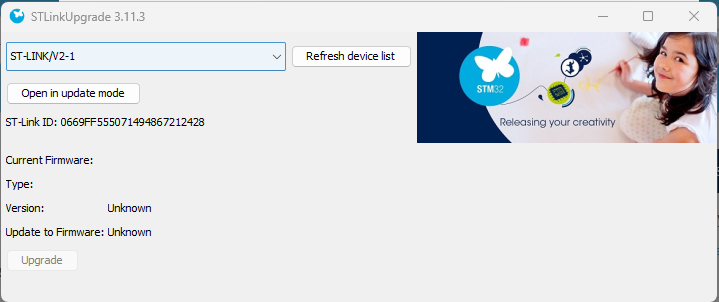

Is it a genuine or clone v2
2023-03-19 4:29 AM
genuine
2023-03-19 4:35 AM
When ı click open in uptade mode it is writing no device connection.

Open in Update mode
Wait for drivers to load, or check Device Manager.
Is this the Discovery Board?
What version of Windows?

Yes, discovery board.
Windows 11.
2023-03-19 5:19 AM
I checked device manager. And it said drivers are already updated.
2023-03-19 5:40 AM
Do you get the Windows attach/detach sound when you click "Open in Update Mode" ?
The version information usually doesn't populate until it is in update mode.
Can you try a different machine?
Cable? or USB port?
Is this using a hub or docking station?
