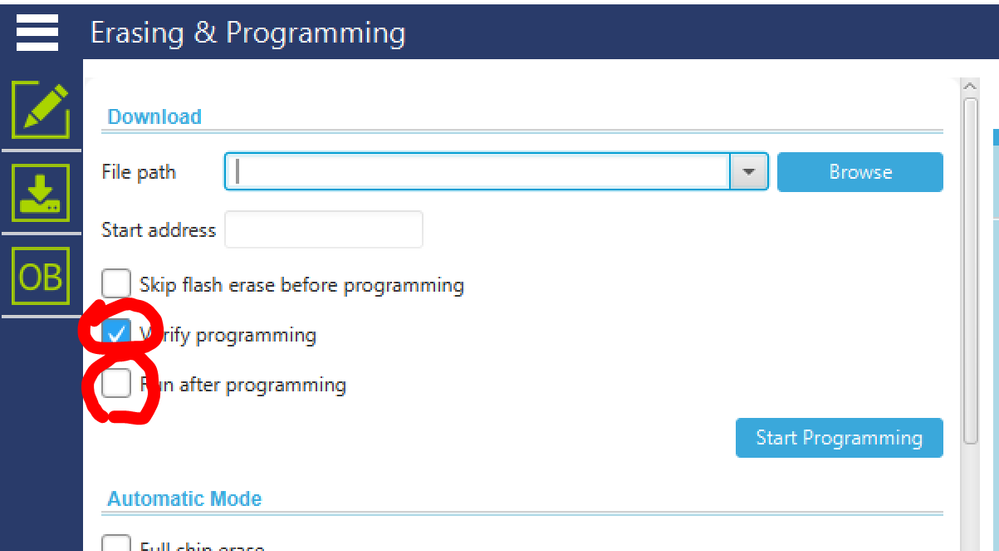

There are a variety of ways to verify. Here is one of them. It sounds like you also want to run the program afterwards.

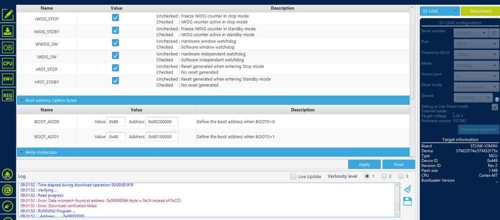

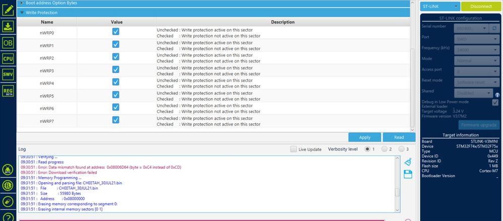

Check relevant option bytes which could be preventing it from writing. Show the log.

how to check the option bytes are relevant or not?
will you please help me to know more about option bytes?.
2021-08-04 9:19 PM
what should be the option byte boot address?

Are any other relevant option bytes set that would prevent writing? Is secure protection off? Is RDP reported as level 0?
