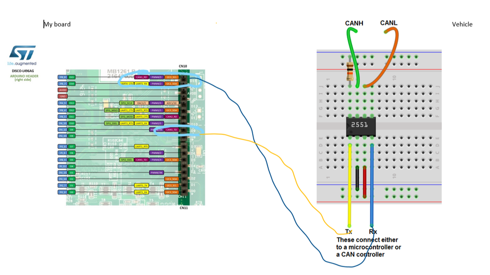

The hardware of the circuit is similar to the draft below. Having trouble with programming to the vehicle. Need assistance programming to the board's specific pinout.

So are trying to sniff data your vehicle is sending to the control units?
Can you show your current code? And point out what is working and what is not, so we can help you.
From where did you tap into the canbus?
What is the speed of the bus?
Is it Can A or B bus in first place? (atleast Mercedes uses others aswell)
Have you verified that you need 120ohm termination resistor? (it's not always needed depending on the bus, and might even corrupt the data based on my experience)
2019-10-13 5:56 PM
So essentially use i want to sniff the data from my vehicle is sending.
As a start i just want to be able to send and receive CAN messages, then I want to use that to ocnnect to the vehicle and receive the data and transmit it to be viewed on the PC.
Yes I've verified the resistor using the MCU. I followed this PDF for using CUBEMX for STM32L4 MCU's for CAN messaging. The main code isn't recognising any of the variables or filters I added in after generating the code
(e.g. CAN_FilterConfTypeDef sFilterConfig;)
Here's the code that generated with the add ins described by the PDF attached (next comment as didnt fit)
Let me know if I need to explain any more of it - the bold parts arent being recognised.
