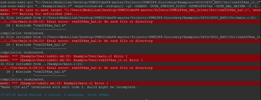

I did what you said step by step, but after clicking 'build' I get this error.
2024-03-15 7:17 AM
Attached a complete project from which you can try the example.
Go to F4_Discovery_Example\Projects\STM32F4-Discovery\Examples\GPIO\GPIO_EXTI\STM32CubeIDE
If it doesn't compile, unzip the folder under your root drive C:

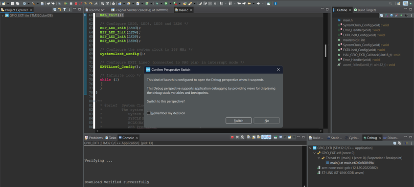

2024-03-15 7:30 PM
First of all, thank you very much for your interest, but when I click on the Debug section, this appears and it seems like it is not normal. I did what you wrote step by step. What should I do? I'm so desperate
2024-03-15 11:28 PM
Click on switch button and go ahead.
