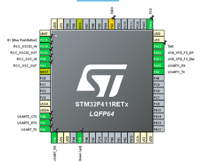

And the screenshot of the pin-out diagram:

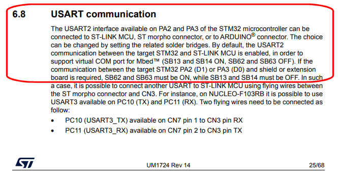

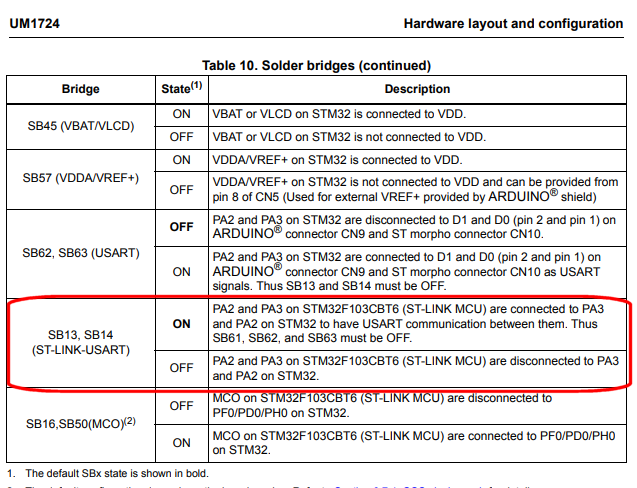

The on-board ST-Link's USB-to-UART ("VCP") is already connected to UART2:
so you're going to have to disconnect the ST-Link VCP for the external CP2102 to work:
Or use a different UART.
See also:
And:
#STLinkVCP #VCPconflict #DisconnectVCP
See also:
And:

@deta wrote:I never thought to disconnect the ST-link, I thought that it'd be fine as long as it was not connected.
The physical connection from the ST-Link's UART to the Target MCU's UART is hard-wired on the board - it's there whether or not the USB is active.
