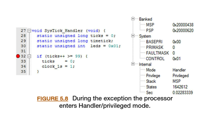

Was looking at a book, see when on SysTick Handler, the nPRIV bit of Control is 1, even though the system is said to be in privileged mode. (
Martin, Trevor. The Designer's Guide to the Cortex-M Processor Family
Bob S
Super User
nPRIV indicates the privilege level or THREAD mode.  Handler mode (interrupts/exceptions) ALWAYS runs in privileged mode.  See ST's PM0253 (STM32F7/H7 Programming manual) section 2.1.1.
