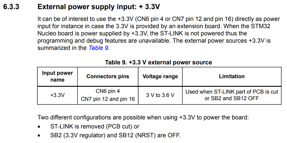

> Will it work if I just supply the MCU with 3V (using the MCU's 3V pin) ? Or do I have to supply more voltage and use the 5V pin because there's some stuff in the MCU part that needs the bigger voltage for the ST-LINK to operate correctly?
The user manual goes into detail on the different power configurations. They don't suggest supplying 3V directly, but give a similar option:
2020-08-15 7:22 AM
I've read that page of the manual. Don't they just mean that if you power the board only through the +3.3V pin (and not connecting to USB) then the ST-LINK is not powered? At least that's what I understand. But what I plan to do is power the ST-LINK part through USB of course. That's how I plan to flash the chip even after cutting the board: by connecting the ST-LINK part to the computer via USB. Am I misunderstanding something here?
2020-08-15 7:31 AM
You need to power two things: the ST-Link programmer and the target board. The programmer is powered by USB, nothing else required. This is telling you how to power the target board that you've just separated from the programmer. Maybe that's not what you're asking.

Ok, thanks. Maybe my writing is a bit confusing. I've understood already how to power the target board with a 3V battery after separating the two parts. I can power the target board with a 3V battery and this target board will do its thing alone.
My question was how to use the ST-LINK again after that, to reprogram the target.
My guess is that the ST-LINK doesn't need additional power than the USB to function. So, you just need to provide power to the target through battery. I was wondering if there was a reason for the 8V power supply they use in the figure posted by KnarfB. Can't I just use the 3V pin with a 3V battery just like when the target board is all alone?
