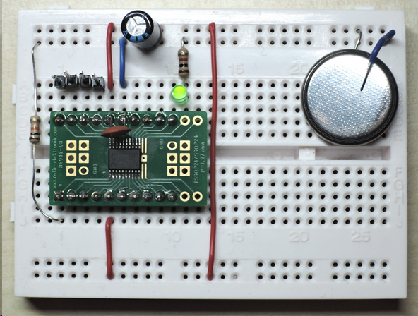

Here is some minimal breadboard with another chip (STM32F031F4) one an adapter board. The first two pins top left are the SWD interface, the next two used as UART. The LED blinks SOS - there is room for improvements.
