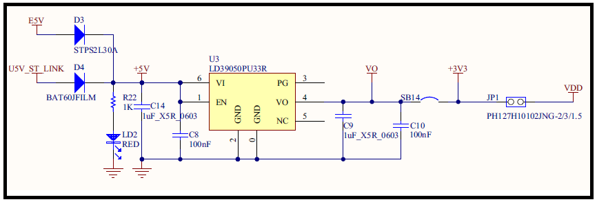

Also consluting the Electrical Schematic I can see that effectively I provide VDD to the MCU also if I supply the board with +5V pin.

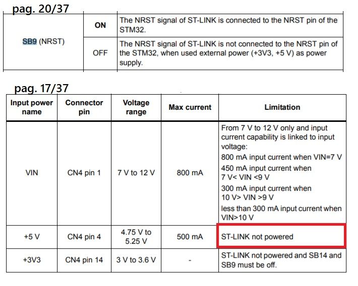

Thanks Pirnha, I found confirmation of your solution in the UM 1956 as show in the figure below, but, at the same time, again in the UM 1956, there is a table which says that the SB9 should be removed only in +3v3 supply voltage case.
0693W00000JNAVaQAP.jpgDo you think it's just an oversight?
Thanks again for your valuable suggestion!
