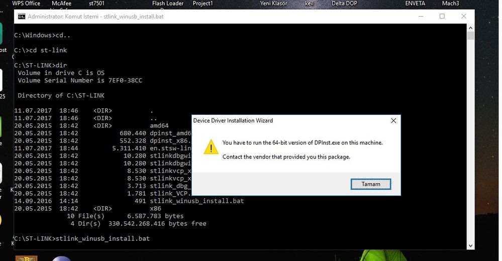

I bought a win10 laptop
where I tried to connect st-link/v2 adaptor
I downloaded stsw-link009 package and tried to install
however I get the message
'you have to run 64bit version of DPInst.exe on this computer'
I couldnot find this version in internet
how to proceed ?
please advice
thank you
#st-link #win102017-07-14 3:50 AM
Hello ! Try to change the path of installing directory by make a new folder e.g at root directory -> c:\abc. Put inside the uncompressed driver and run it again.
2017-07-14 4:51 AM
This message is not from bat file. Is from dpinst_x86.exe. Try to run directly with administrator rights the dpinst_amd64.exe

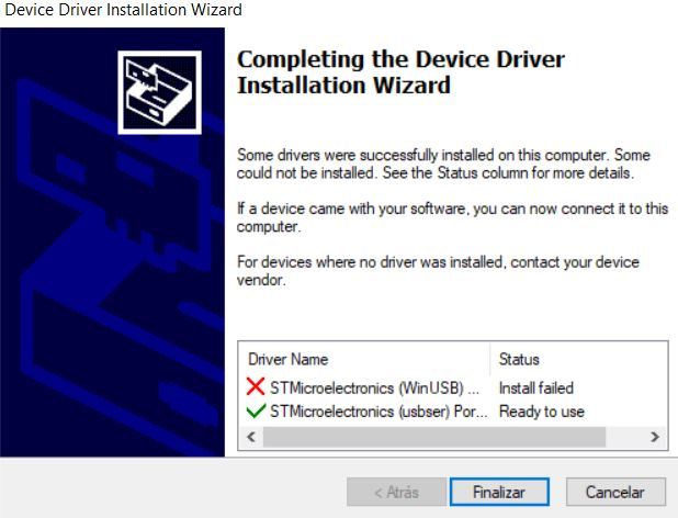

2018-03-21 11:05 AM
Hi
I?ve tried to follow all the considerations mentioned and still have the same error on my Windows10
a) downloaded
http://www.st.com/en/development-tools/stsw-link009.html
b) unzip and run as with administrator privileges the bat file
c) review Device Manager under unknown usb device and try to upgrade indicating to the .inf folder, it fails with '' Device Description Request Failed''
Any ideas?
Thanks for answering
