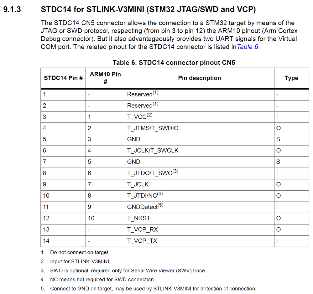

Put a 14-pin header on your board and connect the signals in the table to the relevant pins on your board. For example, T_SWO is the SWO of the target MCU, which is pin PB3 on your board. T_VCC should connect to the power rail on your board. Note that you will still need to provide the board power.
