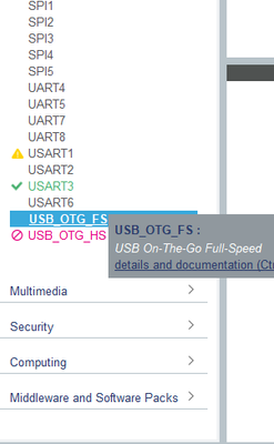

Just disable USB and all goes fine.
PS: USB needs to use HSE with an external crystal. That's why you are having this message.

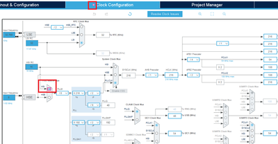

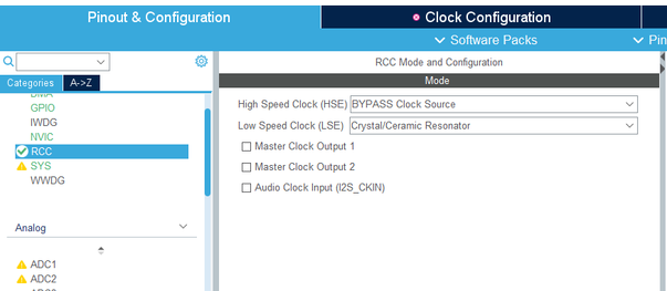

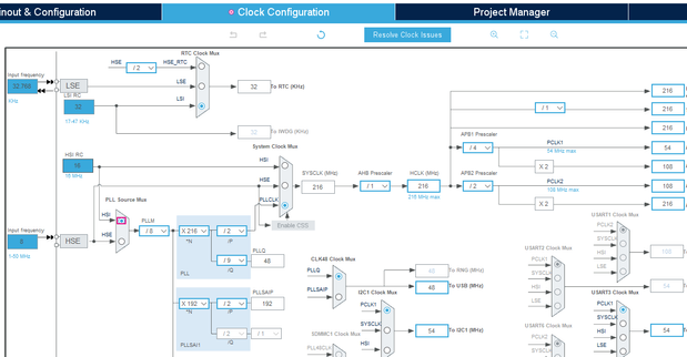

Hello @chulhoolim-nnftech and welcome to the community.
According to the image you shared there is something going wrong in your RCC config. You have an error in the configuration:
What message do you get when you pass the mouse cursor on the red square of HSI selection?
2024-09-06 2:02 AM
Thank you for your reply.
The message is "PLL Mux should have HSE as input"
But My nucleo board doesn't have an input oscillator.
Can't I use that "HSE not used"?

Thanks,
