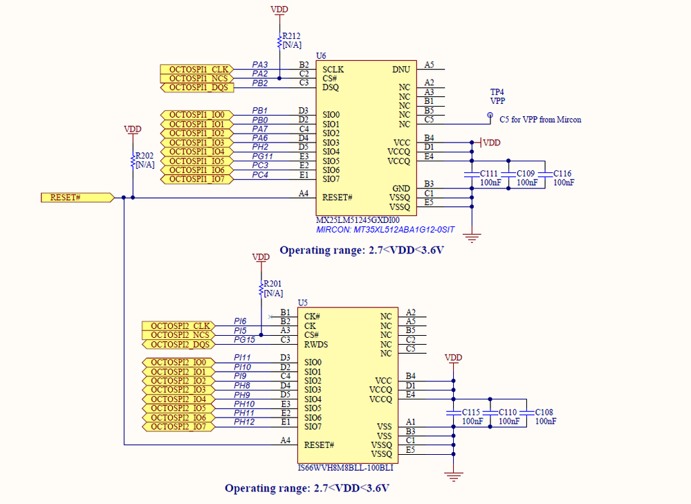

Yes, I think they cross connect the P1 pin sets to OCTOSPI2 via the OSPIM (Mux)
This does seem unnecessarily confusing and convoluted.

U12 is the FLASH
OCTOSPI2

@Community member ,Thanks for your answer.
But by mistake, I have attached the wrong snapshot, corrected it now, and also attaching here:
As per my understanding, U5 is RAM connected to OCTOSPI2 and U6 is FLASH connected to OCTOSPI1 but in the NOR flash example, they are using OCTOSPI2.
Looks like incorrect example, please confirm.

well, that looks like a mistake...
Check the BSP drivers for that eval board, it is using OSPI1...
(ticket 135802)
2022-09-30 12:33 PM
@Mike_ST
STM32Cube_FW_L4_V1.16.0\Drivers\BSP\STM32L4R9I_EVAL\stm32l4r9i_eval_ospi_nor.c
References OCTOSPI1
STM32Cube_FW_L4_V1.16.0\Projects\STM32L4R9I-EVAL\Examples\OSPI\OSPI_NOR_MemoryMapped\Inc\main.h
References OCTOSPI2 for NOR

Now it does map/mux via OSPIM to PORT-1, but this is so unnecessary and confusing for users..
/*##-4- Configure the OctoSPI IO Manager ####################################*/
OSPIM_Cfg_Struct.ClkPort = 1;
OSPIM_Cfg_Struct.DQSPort = 1;
OSPIM_Cfg_Struct.IOHighPort = HAL_OSPIM_IOPORT_1_HIGH;
OSPIM_Cfg_Struct.IOLowPort = HAL_OSPIM_IOPORT_1_LOW;
OSPIM_Cfg_Struct.NCSPort = 1;

Thank you, I completly forgot about the OSPIM on the L4+. :downcast_face_with_sweat:
