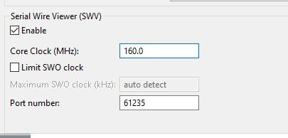

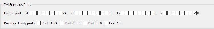

I would suggest to check the following points:
Hope this helps

2022-06-23 9:22 AM
Hello Brian,
Many thanks for your speed answer.
I check, point by point all your recommendations, and everything is ok.
But it don't work.
If i put a breakpoint in my _write function, it never stop here

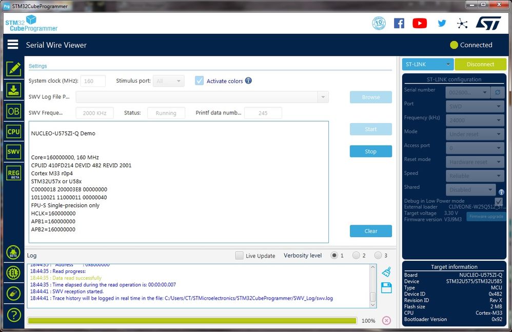

2022-06-23 10:04 AM
+1
Definitely check the ITM_SendChar() outside of the plumbing for the STDIO
I'll check the NUCLEO-U575ZI this evening
